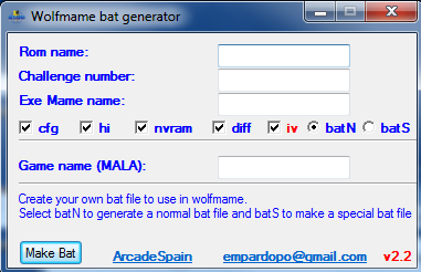

WolfMAME bat Generator
I've just programmed a little program to generate bats file to use in wolfmame.
It's possible to download here.
The program has two options.
batN --> generate two bat files. One to see the inps and anothe to record inp.
batS --> Only generates one record bat file.
You must always submit the rom name and the output bat file will be for your rom selected.
Greetings.
Greetings.
