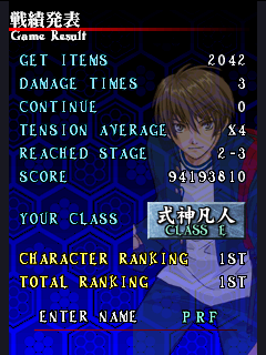

I have been deleting everything manually. I went thru all the folders and deleted everything with the name shikigam except the chd file itself. Also attached is the inp I made just deleting the nvram and I was wondering does it playback at all for you?
Re: Shikigami no Shiro
Posted: Fri Nov 01, 2013 7:41 pm
by mahlemiut
Plays back, but I don't quite get the same score...
